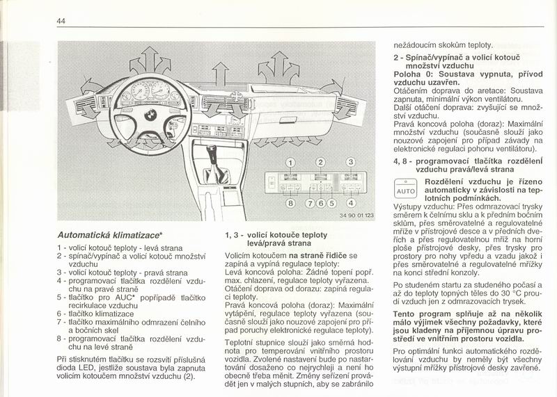

ZDRAVÍM.. NEMÁ NĚKDO NÁVOD NA OVLÁDÁNÍ AUTOMAT.KLIMY NA E34 r.v. 96? POŘÁDNĚ NEVÍM JAK A CO. MUŽE BÝT I V NĚMČINĚ.DÍK

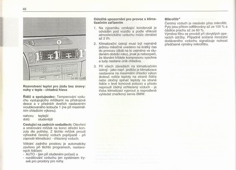

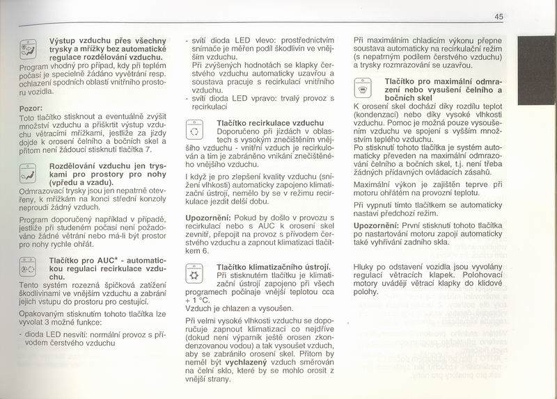

kochej se
strana 044.jpg (112.07 KiB) Zobrazeno 2984 x
strana 045.jpg (107.02 KiB) Zobrazeno 2984 x
strana 046.jpg (74.66 KiB) Zobrazeno 2984 x
