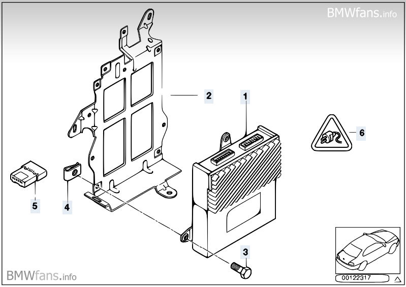

Neviete prosim niekto kde su vstupy a vystupy na tomto konkretnom zosiku.
Ja mam H/K a tento je iny - nechce sa mi to zistovat manualne.
Nemyslim napajanie /+-R/ ale signal IN a OUT
THX.

A18 Amplifier
Plug connector overview
Number X-pin, colour Description
X605 12-pin, Black Plug connector A Amplifier (Hifi)
X606 26-pin, Black Plug connector B Amplifier (Hifi)
Pin assignments at plug connector X605
Pin Type Description / Signal type Connection /
Measuring notes
1 E Terminal 30 Fuse F56
2 E Radio ON/antenna signal Radio
3 M Amplifier ground Stereo/Hifi ground
4 Not used
5 A Positive activation, rear right woofer Right rear speaker
6 A Negative activation, rear right woofer Right rear speaker
7 A Positive activation, front left woofer Left front speaker
8 A Negative activation, front left woofer Left front speaker
9 A Positive activation, front right woofer Right front speaker
10 A Negative activation, front right woofer Right front speaker
11 A Positive activation, rear left woofer Left rear speaker
12 A Negative activation, rear left woofer Left rear speaker
