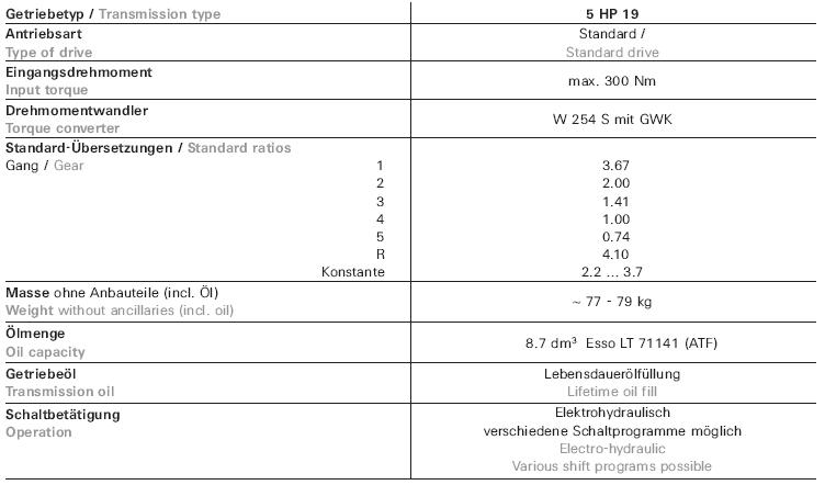

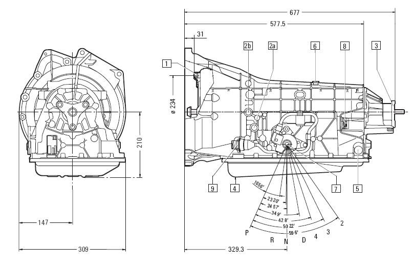

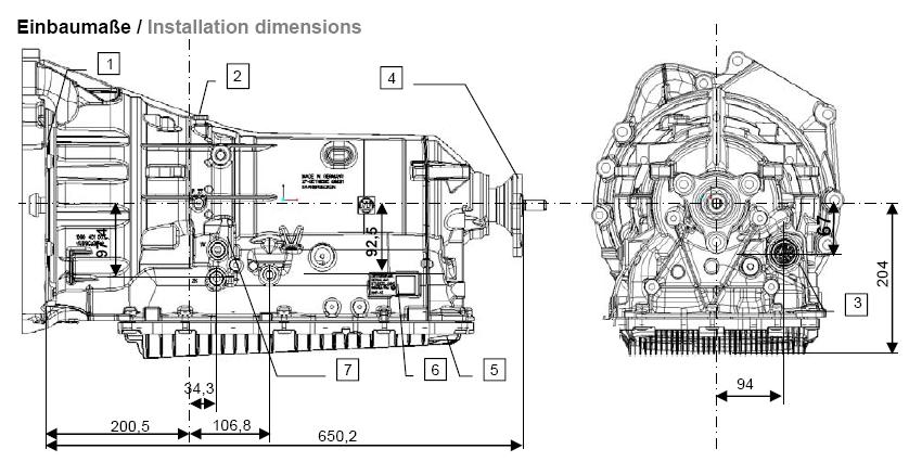

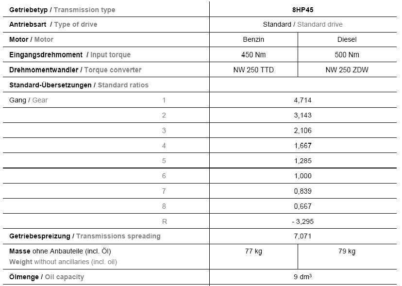

Uz mame odpoved od ZF :-) Jak jsem cekal, boji se polozit "do problemu" :-) Nicmene mam v pdf nakres s rozmery a vsemi parametry obou skrini, jak bude chvile, mrknu na rozdily. Jeste ho zkusim zneuzit na tu 6HP z e60 530iA 190kW :-)
Hello,
I really like your idea, but it is not possible to send you specific drawings or documents of our 8HP. The only thing I can send you, are the technical data sheets of the 5HP19 and the 8HP45, you will find attached.
Please realize that it is "nearly" impossible to change a 8HP for a 5Hp. The hardware will be the smallest problem, but the software will be a big problem. Today the transmission communicates with a lot of control units in the periphery and you have to make sure, that they communicate in the same "language". The next problem are the parameters the transmission gets from the engine. There is a 170KW/231PS engine in the E39 and a 200KW/272PS engine in the F10. That means you will have different parameters for rotation speed and torque, and that means you have to adapt that in the transmission. To do that you need a special development tool which you won´t get and so one.
So these are only some examples you should think about before you buy a 8HP for such a project.
Mit freundlichen Grüßen/Kind regards
T. B.
ZF Services
Technische Projekte / Technical Projects
