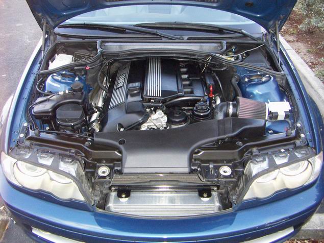

kolem 7tis USD (coz mas ted kolem 150tis Kc) sezenes kompletni turbo-kit Plug and Play pro 330i e46... vykonove to bude lepsi nez celej M5 engine (kroutak, vykon, vaha) a nemusis resit ten oser okolo (navic mam pocit, ze ten M5 engine se tam nevesel bez rezani kastle)

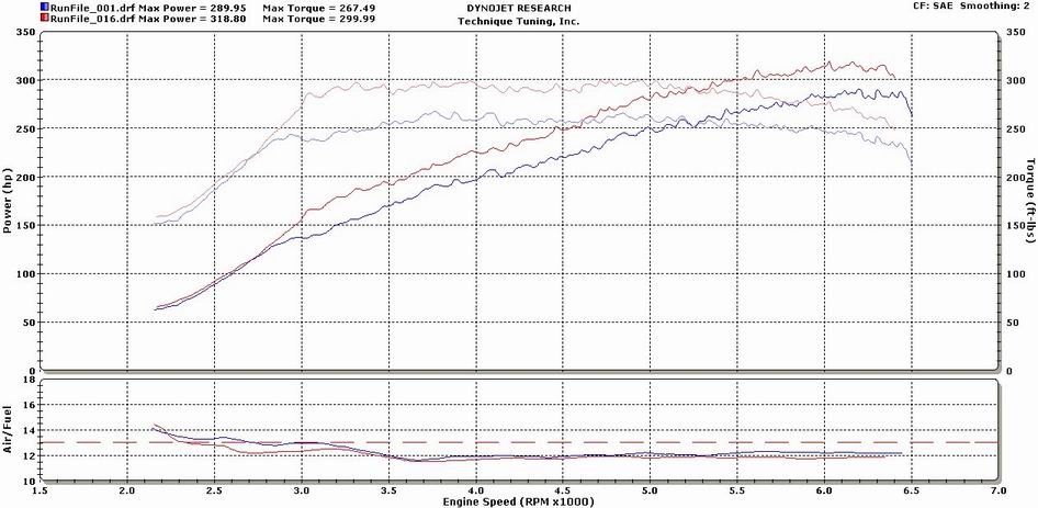

ad turbo: treba od http://www.techniquetuning.com/contact.htm
dělá jedny z nejlépe odladěných turbokitů a software balíčků, cena není ješte stanovena, ale má jedny z nejlevnějších 100% FUNKČNÍCH kitů na trhu (počítám, že to bude kolem těch 7tis USD)
Our test vehicle is a 2001 330ci 5-speed. In stock configuration, the car dynoed at 196rwhp and 198rw ft-lbs. After design, installation, and initial tuning of the turbo kit, the power numbers are now 318rwhp and 299rw ft-lb with 8.5psi of boost. The 8.5psi of boost was achieved using an electronic boost controller (not included with the kit). Running only off of the wastegate's 6psi internal spring, the power numbers were 289rwhp and 267rw ft-lbs.
The kit will be a total bolt-on package. No exhaust welding will be required; no bumper cutting will be needed. There is no ground clearance lost with the installation of the kit. The factory splash shield and brace are retained under the engine. The air filter is mounted high and away from possible low-level standing water. A Garrett designed T3/T4 turbo is used to provide reliable boost, while an external wastegate expels unneeded exhaust gasses to regulate that boost. The large front mount intercooler mounts behind the factory bumper using a laser cut and CNC bent bracket. Our proven blow-through mass air system is retained, which also allows use of a blow-off valve (included with the kit).
Tuning is done via reflashing of the factory ECU and larger fuel injectors. The vehicle's original smoothness is kept. Driveability is just like stock. Until the throttle pedal is pressed that is, as that's when the fun really begins Full boost is achieved by ~2600rpm on the street. Part throttle boost is virtually instantaneous too, giving the car a V8-type of feel (as can be seen by the torque curve's shape).
Graf platí pro:
2001 BMW 330ci 5-speed
Technique Tuning Turbo Kit (6-8.5psi)
93 octane fuel
same dyno used for all runs
same vehicle used for all runs
stock cams
stock exhaust resonator and muffler
stock clutch
